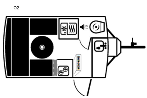

Anyhow, interior pictures here.
Go to Images.
It looks like at least some of them have a stove beside the door where you have full height cabinets. I think I prefer the additional storage space/more pass through room that yours provides.

Yes I too prefer the extra cabinets versus just another countertop space with a stove. I bought a nice outside butane stove that we will probably use for 90% of our cooking and bought a single burner induction cooktop for inside/outside use.
