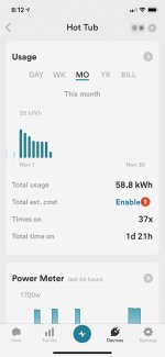

Our hot tub, even being a plug and play but with a more traditional electric heating element (albeit only 750watts or something like that) takes about 36-48 hours to come up to temp running 24/7 if it's handed a full load of cold tap water.
The "coiled around the motor" heating system is interesting and certainly seems to be a good setup so far as recovering what would be otherwise wasted heat anyways. Guess we'll soon find out how long it takes to heat things up. At least you picked a weekend (off peak electricity rates all the time) to get through the first hump consumption wise. ;)
As for monitoring consumption, I have a whole-home energy monitor by "Sense". It's a geeks dream so far as being able to monitor things and see where your energy hogs are, what's using what at what time of day, etc etc. Here's this months stats on the tub:
As you can see, as the weather has warmed up the daily consumption has gone down. Biggest monthly day so far was Nov 1'st using 11.3kwh. Yesterday, 6.5.
For comparison, in the dead of winter, looking back through the logs, January of last year it used 360kwh.
The Sense unit is pretty cool, but not cheap. If you're looking at something simpler to keep track of energy usage of the hot tub specifically, Costco sells a 2 pack of CE Energy smart plugs with energy monitoring for $26. ;)
