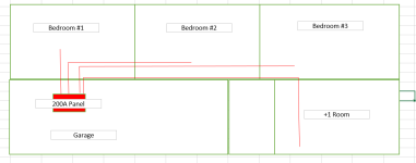

As part of that, I'd like to re-wire the house as well so that it's properly done once and for all. I am considering running conduits from the panel (in the garage) along the wall of the entire length of the side wall as each bedroom is on this wall.
Something like this...
There's block wall, and a walkway b/w the Garage and the +1 room.
Does it make sense to run conduit for each room separately? Or just wire from the panel to each individual bedroom?

If you are going to run conduit, make sure you run conduit that is allowed inside your house and run wiring that is allowed to be in conduit. I've seen far too many outdoor runs of conduit with romex or exposed PVC indoors. Both no bueno.
I would not run conduit to every room. Drives the cost way up and little benefit. I would probably run larger conduit to each space (maybe linen closets on each floor and the attic) to allow future non-power uses such as ethernet, cameras, etc. Make sure you have a plan on how to get a line through. Conduit without a pull string is not fun.
I would not bother with the conduit, just run NMSC to each room. More cost, more work, little if any advantage.
It is nice to have each room on its own circuit as it reduces future head scratching... Some like to have lighting separate so a trip does not make the room dark, I am not one of these...

An option was to go outside, and run it outside, but not sure it's the best route. Another option is to run up to the attic, and run it through there to each room independently.
I'd like each house on a separate circuit, and install a 60A sub-panel in the laundry room that will feed the other half of the house.

Thanks for the offer @backmarkerducati. Can't go through the basement as under the garage is earth. So need to go up and across. There is wiring through the garage to the second half of the house, but I may cut all those off, and do the basement, kitchen, and dining room from the 60A panel directly.
