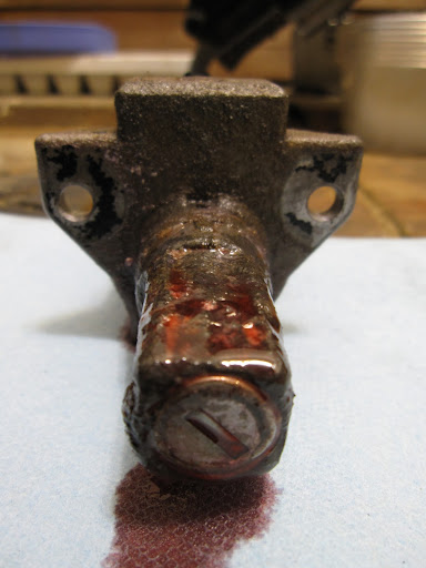

Started to look into the ignition, been sitting in ATF since I posted the pic when I first got it out of the bike... This guy's going to give me a hard time....

So, tonight I ripped it all apart again. Engine out, front end off... Down to the frame and wiring. Not at home tonight so can't put up pics but it's nothing too exciting... I need to figure out how I'm going to repaint the frame, my options are: paint gun, spray paint, or send for powder coating... I figure powder coat will look the best but obviously will cost the most. Any great success stories with spray paint???
Oh and the ignition... No change... lol
