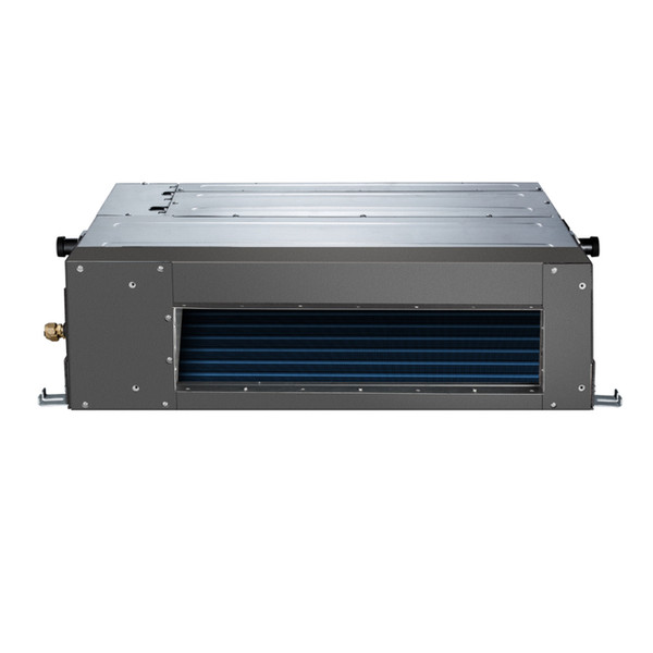

You can get ducted air handlers for small houses. They don’t mount into the furnace but will deliver decent flow to a few rooms. If you get a 2 zone mini, put one come in the biggest common area, then the air handler in the attic for three bedrooms. Or Cold air falls, so the basement will stay cool.
You can get ducted air handlers for small houses. They don’t mount into the furnace but will deliver decent flow to 2-3 rooms. If you get a 2 zone mini, put one come in the biggest common area, then the air handler in the attic for three bedrooms. Cold air falls, so the basement will stay cool.
Wow never even knew this existed….need to look further into this.
