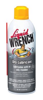

I'd use a dry lube like Teflon spray long before I used anything that stays wet and collects dirt.
Agreed, dry lube for sure. I use WD40 Specialty Dry Lube and it works excellent. I bought it mainly for my bicycles but have found plenty of uses away from that.
I’d clean them using WD 40 or contact cleane, then blow them dry and clean.
Don’t lube those switches, they are designed to run dry, the plastics are naturally slippery and should be just clean, not lubed.
Any lube will collect debris, even dry lube.
