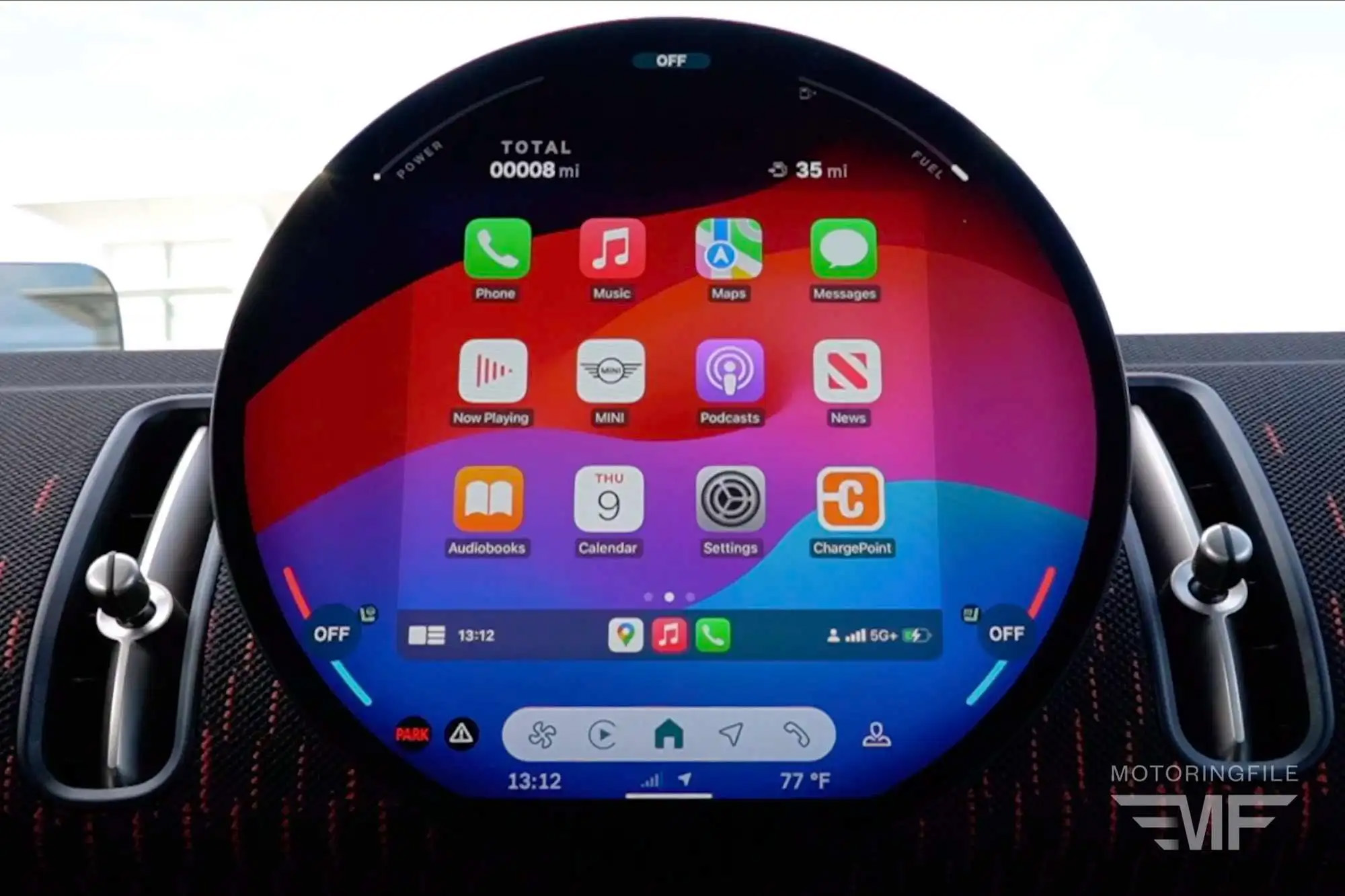

Indian did a nice job on their FTR when they replaced the ugly rectangular screen with a round one to blend in a bit better with the styling.
Hmm, my next search will be round apple carplay screen...
EDIT: NOPE, Apple insists on a rectangular UI
Ask and ye shall receive:
For cars (Mini Cooper), so obviously too large for a motorcycle, but it shows that others are also thinking along the same lines...
