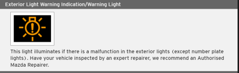

Wow….thats surprising that it ripped. Did you note any lights on the dash? I assume you were able to drive it off the highway with no issue?
I’m preparing my mom for a new car…hers is looking more likely like a scrap.
Yes, there is an additional light on the dash:
which is funny because the headlights are fine, the fog lights are the ones that dont work
Seeing how its main wiring harness.
You you might be looking for a new car.
Or without this one for a long time
