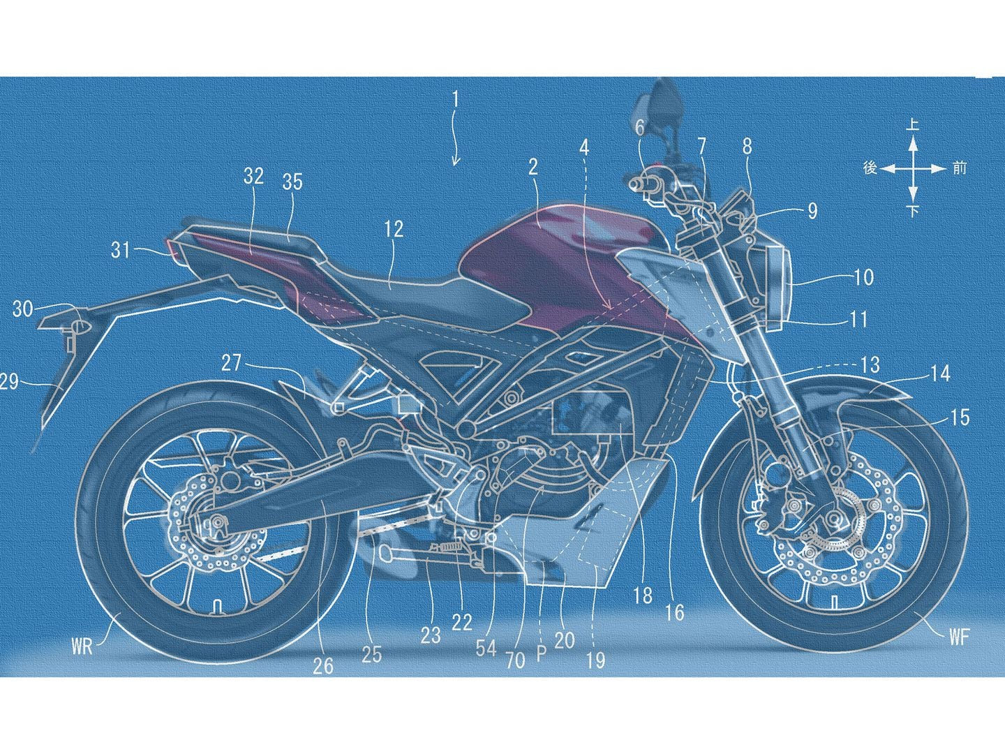

I do like Honda's approach. Stick with proven frames....build an EV motor to fit existing frames. Will be my next bike.
I'm happy with the ergos of the CB300F...would be nice to have some punch. Needs a 300+ km range which with two batteries should be doable. Speeds here are low tho would be interesting to see how much the Gillies eats up the battery.
