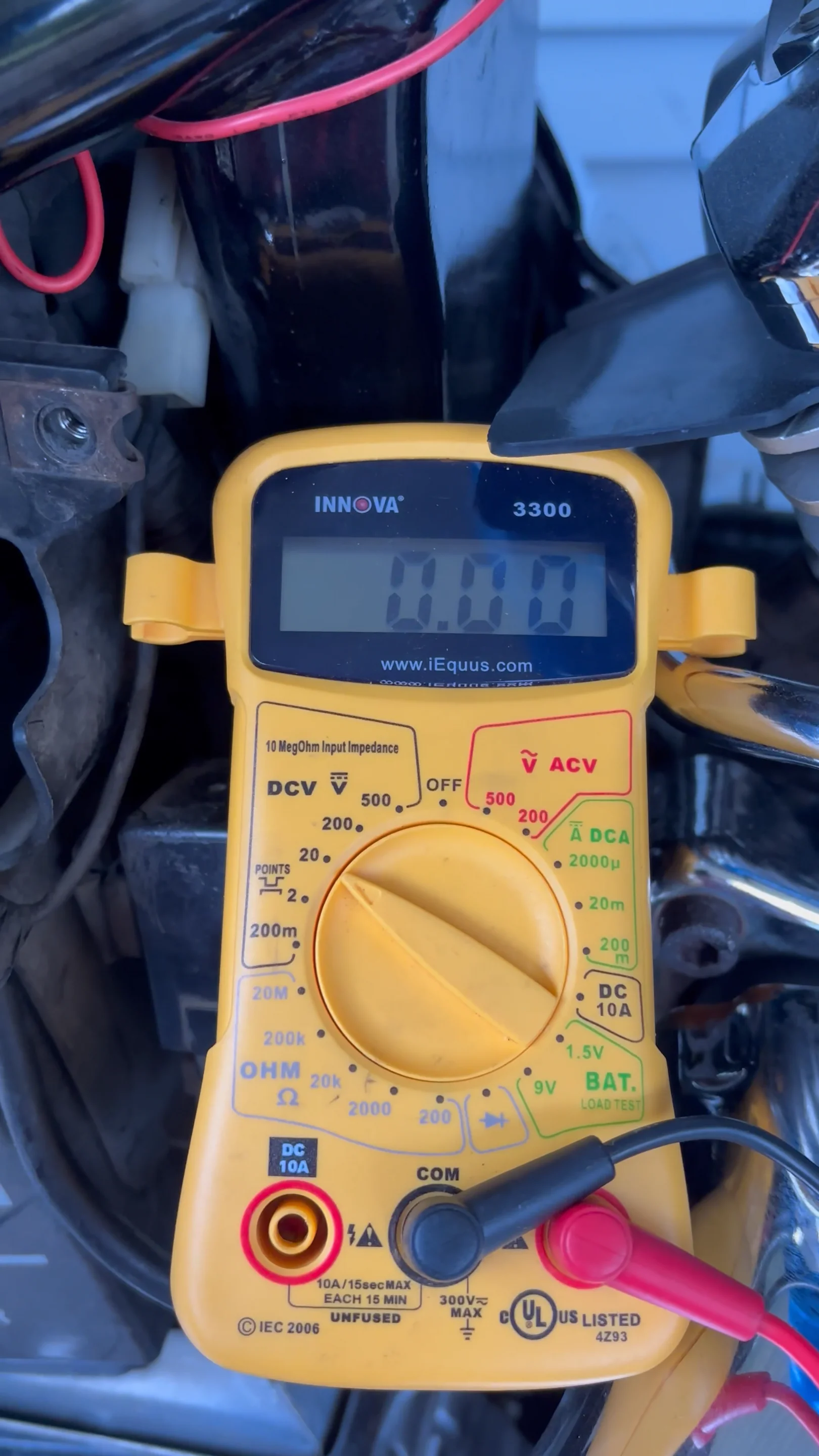

So when I pulled the plugs, and tried it was exactly the same as when plugs were in the engine like before nothing changed, did not matter whether key was on or off or hitting the start button all was the same
So then I decided to try this
When I put the multimeter on the starter (positive) and then the battery ground for my negative and then I turned the key to on and then hit the start button it only shows like 3-4volts at starter

The video suggests the starting solenoid is firing, but there is something with high draw preventing starter from going.
is that a red wire toed to battery ground? If so, does it belong there? Is it a ground?
