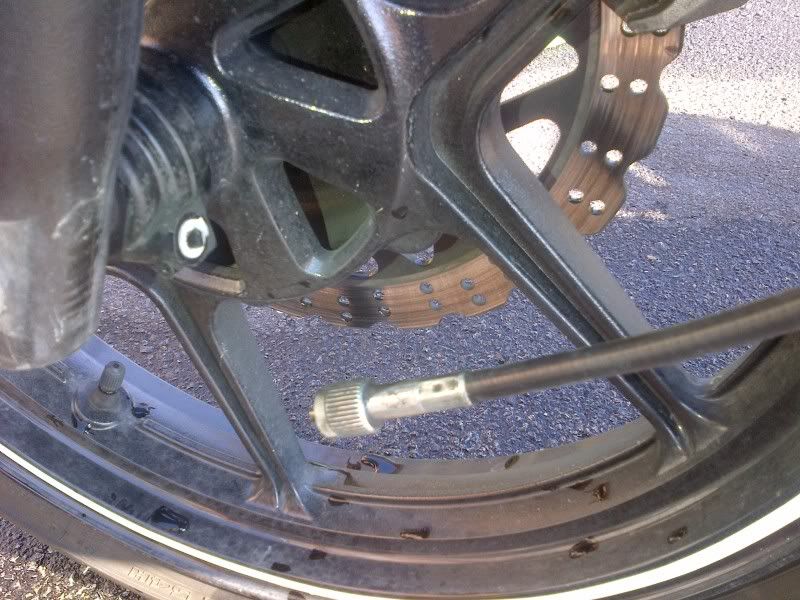

I was washing my bike and it fell vertically (it was still on the rear stand, so it didn't fall over), but the stand broke the cable. I'm an ignoramus when it comes to bikes and cars so I don't know if this is a big deal or not. I'm pretty sure it's not the brake cable (maybe the speedo/odo cable?)

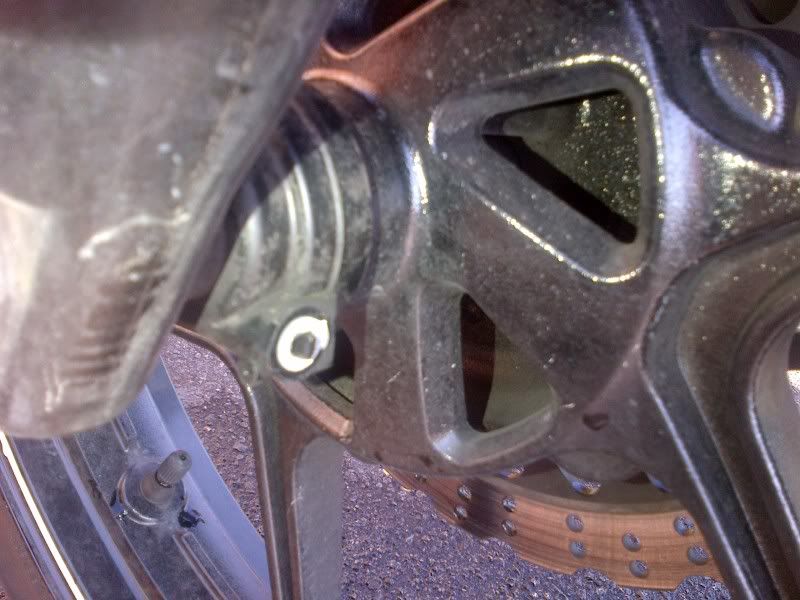

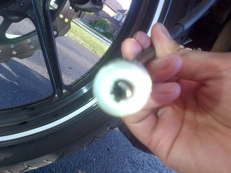

The plastic snapped & the other half is lodged in there. Is this an easy fix?
Thanks in advance, guys
It's not a brake cable since you'd be leaking fluid all over. It looks like its the speedometer cable. They're $15 to replace.
As for getting out the broken end, you may need to squirt some penetrating fluid onto the threads of it and try to snag it with pliers.
Someone more knowledgeable than I will suggest a better method to remove it.
Yeah pliers..or grind a slot in it and use a flat screwdriver..it's just the odo cable, no biggie..apart from the lack of speed reading of course.. :-)
Bad news you broke the front speedo drive hub and it will need changed the speedo cable is probably fine. Try and get the broken piece of the hub out of the cable and order a new hub. Once you hve the new hub it is easy to change but you need to remove the front wheel.
looks like it's just the threaded part of the cable that's snapped off inside the hub. I'd look into a small bolt extractor to thread that piece out, then replace the speedo cable. the hub might be ok, but if it is damaged, it's not hard to replace.
