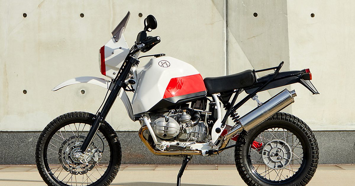

Paint by Robbie Nigl of Peach Pit Paints.The man behind the "Muffin".
I'm curious - why use spoked wheels for adventure bikes?
Aren't they more susceptible to damage vs cast or forged wheels?
Actually, they're less susceptible to damage than cast wheels.
It comes down to rigidity vs flex. The spokes provide a lot of flex and transfer energy throughout the wheel when running on rough terrain. Cast wheels are more rigid and are great for transferring power to the road, but on a hard enough hit, they will crack instead of bending like spoked rims.
A bent spoked rim can be cajoled back into shape trailside using a rock and tire irons. And even if it's not perfectly true, the inner tube will still hold air till you can get back to civilization.
A cracked cast wheel needs to be replaced or TIG welded. Not something you can do on the side of the road. And if you are leaking air and don't carry a spare tube (not many riders running tubeless tires do) to stuff inside the broken rim, then you're calling for a tow.

He echoes my concept of how motorcycles should be. It's a very simple motorcycle, easy to repair with simple hand tools. You don't have to worry about fuel pumps or water pumps failing, leaking water gaskets, leaking hydraulic brake lines, it's just a very simple machine that is easy to improvise to keep running in the middle of nowhere. Simplicity has a beauty all its own.
They don't say what kind of compression he's running, but that has to be relevant since fuel quality is poor in many places and it could cause detonation. He's running carbs, so there's no computer to back off timing. Therefore he's either taking chances, or he's running about 11:1 with a rich fuel mixture. I'd say the low-end torque is what will make that bike sing on the back trails.
Suffice to say though, even in the most remote parts of the third world motorcycles are now common, and so are people with the skills to repair the less sophisticated ones. Watch an "On Her Bike" vid and you can see that only a few places in the world are so remote that a bike like an Enfield, old BMW, or Honda can't be repaired.
