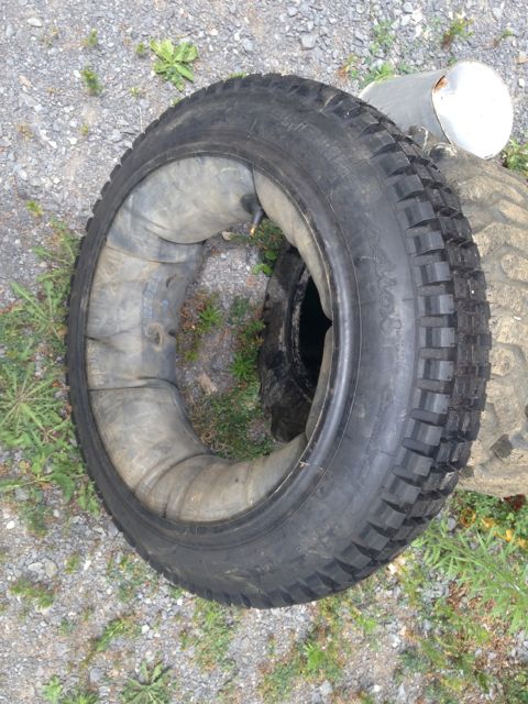

I pre stretch them the night before by sticking an inner tube inside it and inflating that so it stretches the sidewalls outwards.
Seems to work for me ok.
