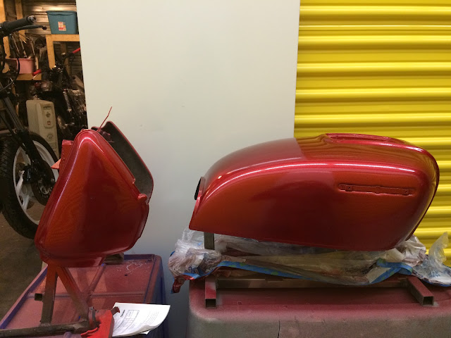

Here is the tank and side covers with 2 coats of 2K clear on it. Because the colour coat has a lot of flake in it, it was a little more rough than a typical straight colour coat. That means that the first coats of clear will be more 'orange-peely' than usual. I used 1000grit to wetsand down the 2 coats of clear to smooth it out.

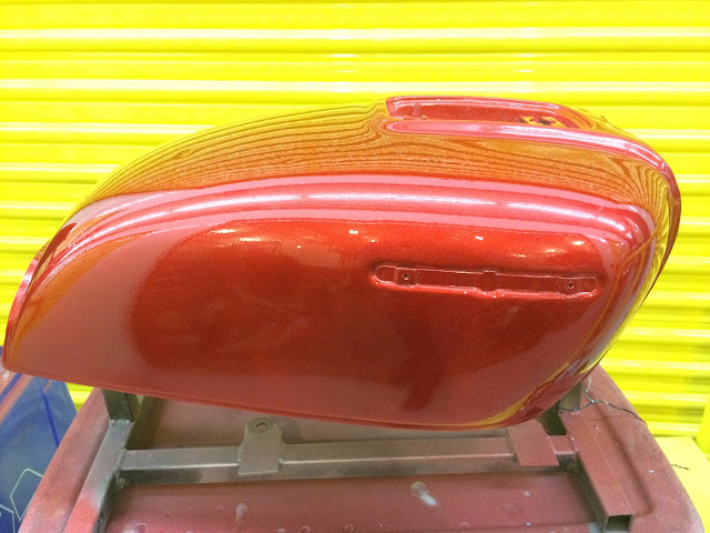

Here is the tank after the wetsand and right before the 3rd and 4th coats of clear go on.
After the 3rd and 4th coats of clear.
Not that I am worried, but it looks like this red is going to be deeper, and not quite as 'fire engine red-y' as the grips and plug wires. So, if it looks to weird with the two shades of red, I will remove the grips and maybe even the wires and go with black. I just need to be mindful of the fact that once you go black, you don't go back. ... I think I heard that somewhere, don't know if it applies here.

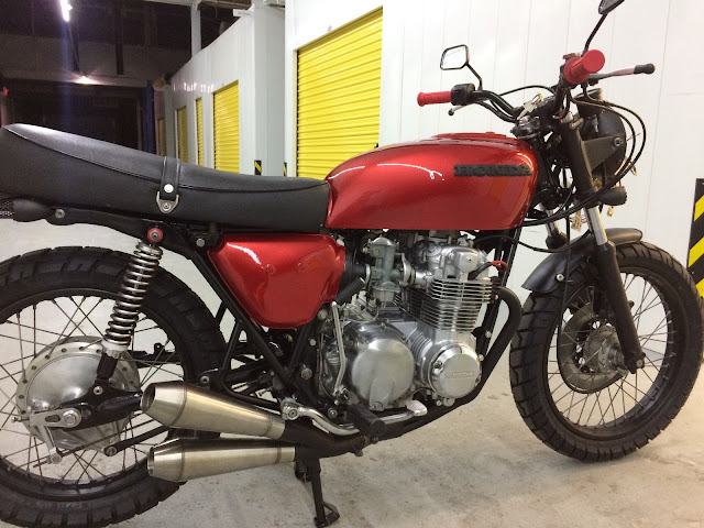

Here is the finished paintwork, mounted on the bike. The 2K clearcoat looks great. This is without any buffing or polishing either.
The only thing that remains is to put all the wires into the headlight bucket, fill with gas and oil and fire it up. Then get some brake lines made to that I can do burnouts.
