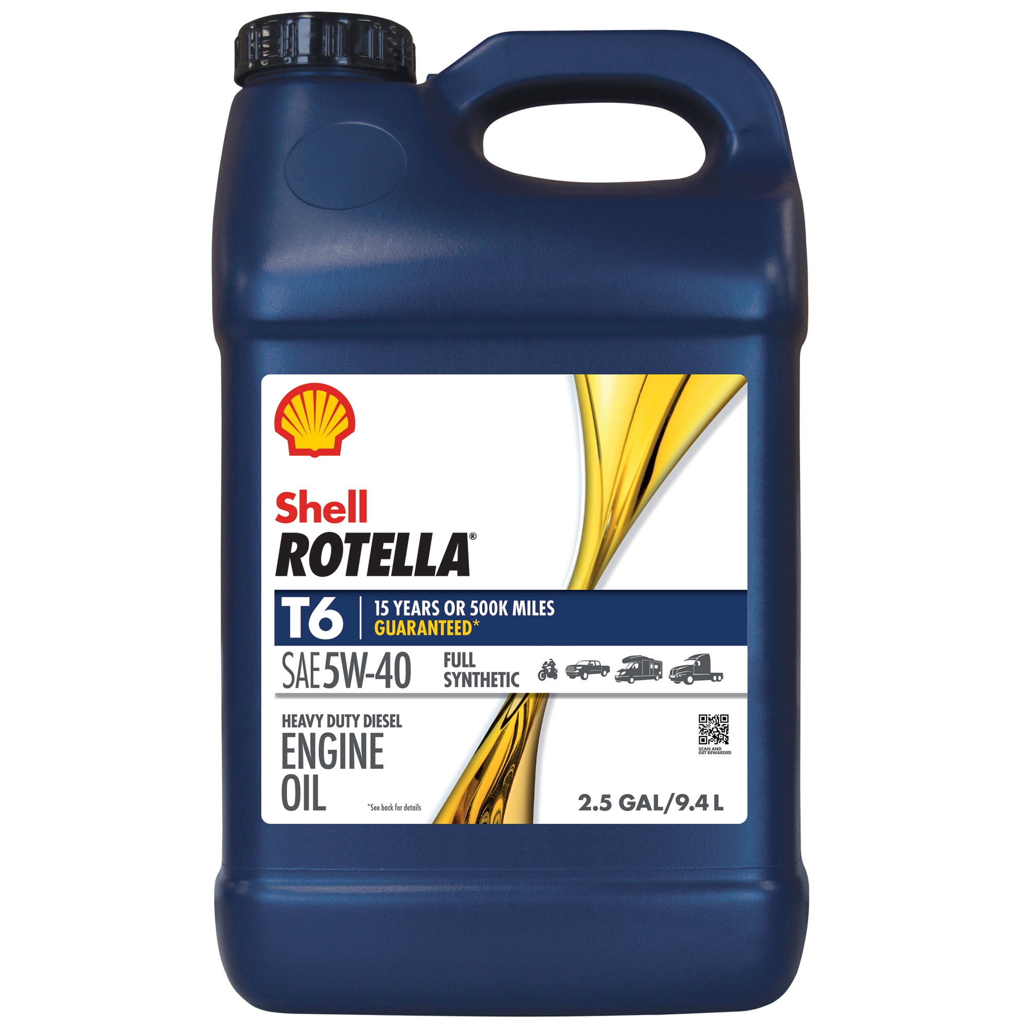

Rotella is no longer marketed as Diesel oil
Ummmmm... Fact check.
Yes, it is. It's right on the tin actually.
(truckers know Rotella is NOT good oil
Ummmm... Also gonna fact check this.
Rotella is actually extremely highly regarded in the trucking industry, and I should kinda know about that since I've worked in it for coming up on 30 years and it's what our fleet uses, and we have lots of tractors with in excess of 1M km on them now.
