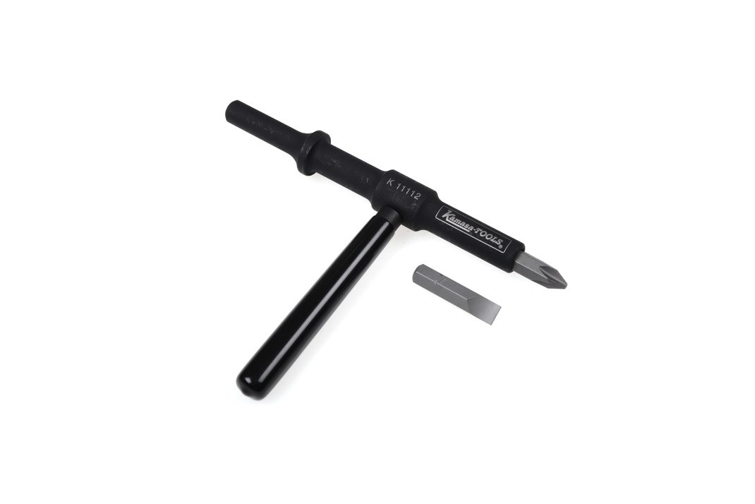

If you have access to air I prefer ones like below. The air hammer takes care of the tapa-tapa-tapa and you can easily control the armstrong torque.
They can work. I have a bunch kicking around and almost never use them. For some situations(like leaving in a vehicle toolbox) they are great.
I have one of these, it only worked for me on giant screws -- keeping the tip in the screw is nearly impossible once you hit the chisel trigger.
