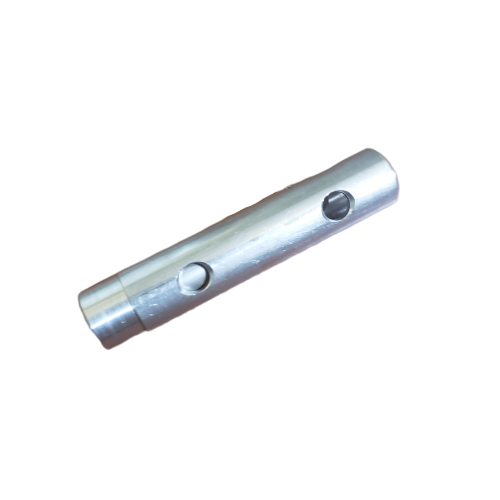

Wix filter?? I would just be glad it had a filter and was assembled correctly. First oil change on my KLR I found out the bypass tube had been tossed with the (last?) filter.
