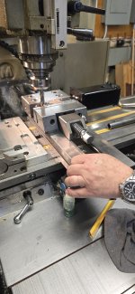

I have several methods available. For that I would have zipped it in the chop saw or scribed a line and cut by hand. I have an assortment of end mills and carbide tips for sale if anyone is interested.
That looks like work. I'd rather press a button then go surf GTAM on my computer. ;)
