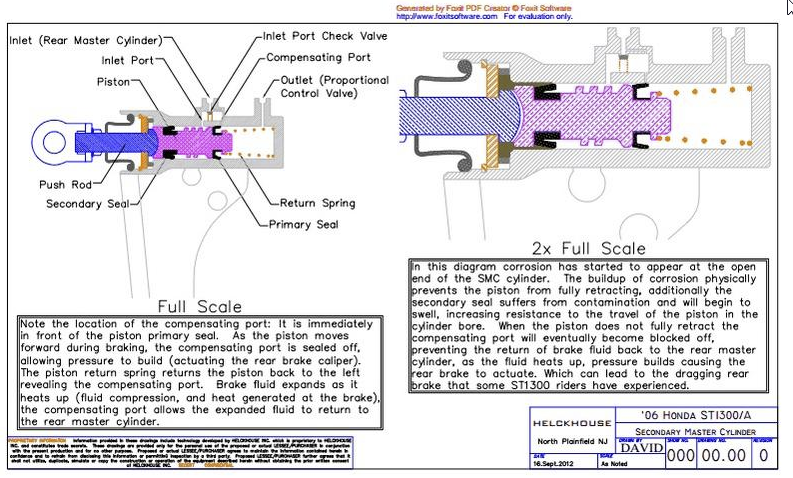

can you show a photo or link a parts diagram to show the part and do you have a service manual?

Hi,
On top of the left front caliper there is a secondary master cylinder that activates the rear brakes. This is leaking so my rear brake disappears. I have ordered a set of used calipers from UK. Expect to get them next week.
Is it a Nisin 4 piston calliper ? non abs
oh, the linked brake kind of secondary master, can you buy the rebuild parts from Honda,
or is used a good solution for that too. You can rebuild them if it's not physically damaged or the aluminum parts corroded, its messy and not easy.
carlsalter.com has a free service manual download for the VFR800FI Interceptor if that is of any value to you
Parts manual exploded diagram is your friend, it's also handy for putting things back together in the right order, there is about 6 tiny parts to a brake piston master.
