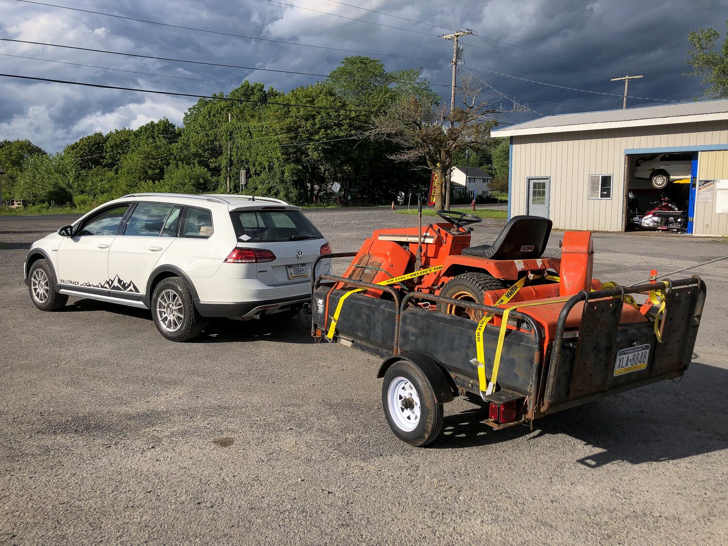

VW Golf All-track. Come in Manual, 4WD, and will tow. However like above, I would spring for an Ecoboost F150, that is the right tool for the job, not sure why you want to tow with a manual car.
