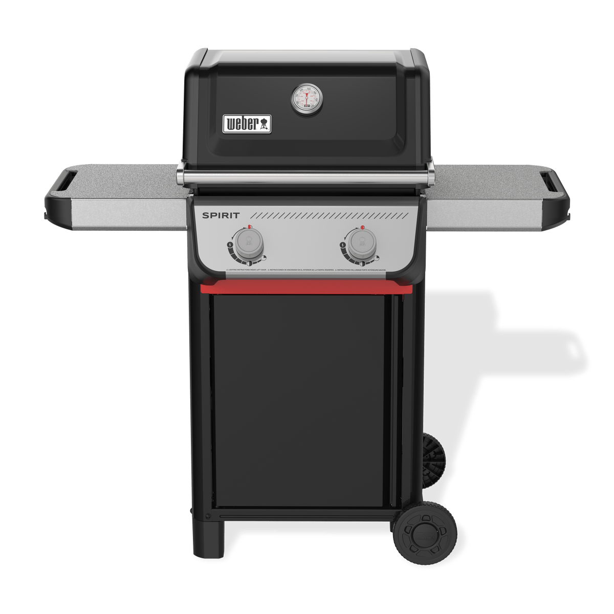

My hard plumbed NG que just gave it up. I just want a simple 2 burner unit but for some reason the selection with NG seems higher end and I'm struggling to find simpler 2 burner units.
I think the difference is only jet size. Can I drill out propane to run NG or is it the other way round?

Most of those are LPG only. The masterchef allows conversion and the kit is $65.

The weber patio 2 burner I saw at BBQ galore has an NG option.
