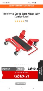

If you have a centerstand you could use this type of thing, but they're the same price as the kickstand dollies: BikeTek Deluxe Centre Stand Bike Mover The Visor Shop.com
A conventional cheap moving dolly will be too tall to use with a centerstand.
