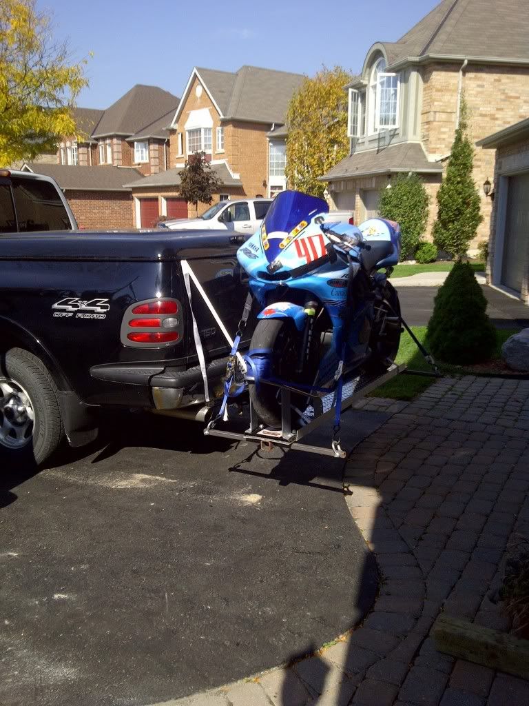

Mines a homemade job and it works great! even got pulled over and cop made no issue about plate hardley visible.
I do add 2 extra tiedowns as you can see in the pic up and over my tailgate and to the tie downs inside the box to help with the tongue weight issue and prevent the wobbling and bouncing on the highway.

Instead of trying so obviously to try and detract from something that works for so many others, why don't you give it a try yourself, I wouldn't mind showing you how my setup looks at some point.
