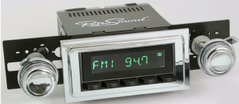

For music, I would just use a bluetooth speaker. I expect that you could buy a plug and play radio that worked but it will cost much much more. I strongly dislike the look of modern radios dropped in classic cars.

Do not cut the dash, and really do not cut the dash to fit a modern radio. There are companies selling modern equipment that will fit the current dash openings. Or as GG noted, just leave the old one and go hidden bluetooth or just under-dash modern (NOT CUTTING).

Stereo - can use the old/modern unit posted already or get a bluetooth connector and plug it into an amp/speaker setup you can install in factory speaker openings.
