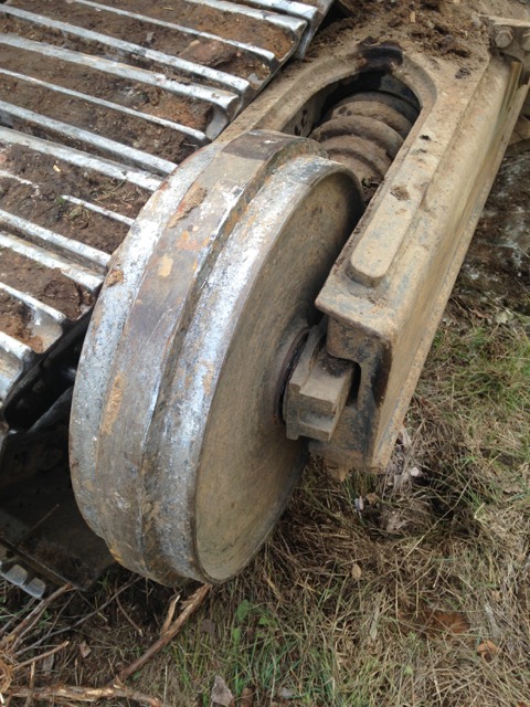

I had to replace a sprocket and reinstall a chain just last week,
the sprocket on it's own weighs more then your entire motorcycle. It was a fight with hand tools and trying to figure out how to deal with not being crushed by the chain or the sprocket.

Ahh yes...last years Harley Ultra (steel belt conversion kit)
