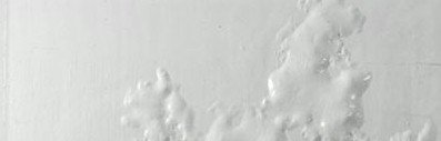

looks like rust running out of one hole. how bad is the inside? the late Ross Thompson said he hooked his shop vac in reverse and blew air through it for about 20 minutes before welding with no explosions reported.
last time I mentioned this some bright soul suggested a spark could travel out my hose and ignite the tank. so maybe don't do this if your vacuum is a POS.
Inside is ok, some surface rust here and there. I would just clean and use if it wasnt for the holes.
Vintage Honda unit, I think it started leaking after paint and its clearly had repair attempts.
