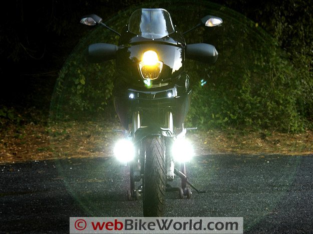

Thanks MacDoc for this inexpensive alternative to a modulated headlight unit.
Inexpensive, but asking for trouble. If a cop is having a bad day, good luck getting yourself out of this ticket (you will probably win in court as the law limits blue and red flashing lights, but I can't find any mention of white). The operation of a modulating headlight is clearly defined (and these don't come close to any part of it).
As white strobe lights don't appear to be restricted, you could throw up a pole and a proper strobe light (like the ones on top of busses) and increase your visibility from every direction, I've never seen anyone try it though.
