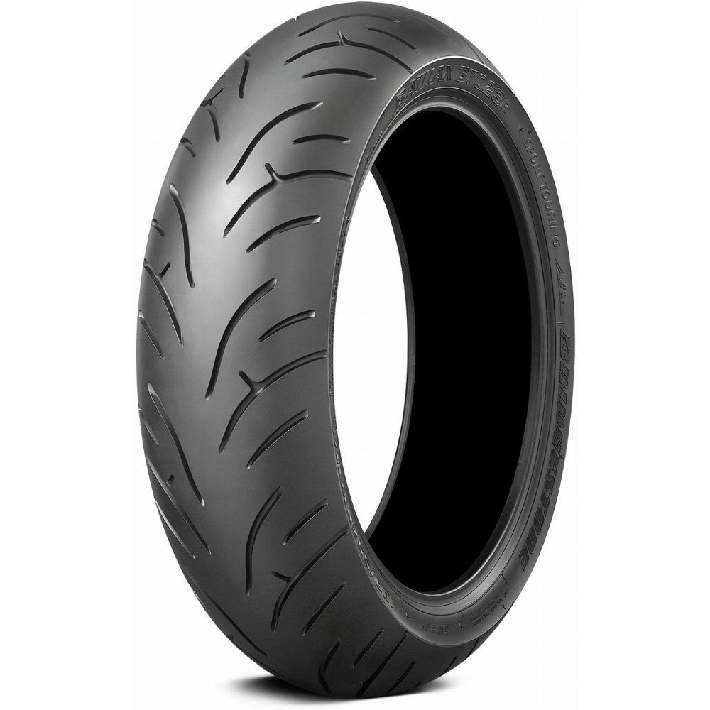

I have a quick/dumb question regarding tires for my cbr500. I'm looking at the Bridgestone BT-023. I know the size for the front tire is 120/70ZR17 but there's an option for "F" spec or "G" spec with about a 35$ difference. Any idea as to what the difference is between F and G spec are? Thanks in advance!!

I think @TK4 is on the right track (pun intended), as the BT-023s have two different specs, the normal and the GT Spec:
GT specs available in 120/70-17 and 180/55-17 for heavier motorcycles. GT specs have heavy duty casings. Revised tread pattern - front only
I think the Type F/G/M distinguishes between GT and non-GT spec BT-023s, depending on which bike you are mounting them on and its weight.
this site shows the G spec for the Honda and the F spec for two Yamahas...
It's pretty poorly documented and inconsistent across sites, but it does designate an OEM tire for a specific manufacturer. It may also indicate a GT version depending on the bike. In this example the F spec is for an FJR and is about $145 vs. the G spec at $113 for a much lighter bike.

The G is the general spec, any other letter designates an OEM spec version of the same basic tire. In this case the F is a Honda design, specd specifically for the NC700. You can interchange, just the F has a harder compound and a tread designed to shed more water. It will last longer, gives up a bit of traction - probably not enough to notice on a CB 500.
GT is not the same, that's a generic designation for heavier carcasses on grand touring tires designed for high mileage on big bikes.
