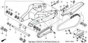

After figuring out the specialty tools, I popped off the nut (part 17 on the fiche below). First warning, as it had a fair bit of corrosion and took a good pull to break free. After that, I loosened the adjuster nuts (parts 18, look like castle nuts) and went to spin out the pivot bolt itself (part 7). The bolt did eventually come free, but it took a 24" breaker bar with an extension to get it shifted. I spun it out slowly, spinning it back in periodically to help clear as much of the corrosion as possible. It took force all the way out, and never came fully free. Towards the end of the threading, it started taking the swingarm with it, so that as I turned the bolt, I'd have to pull the swingarm back down to carry on. It also got much harder to turn at this point. I should also mention that I had hammered on the opposite end of the bolt at various points, and used liberal amounts of Liquid Wrench, neither of which seemed to make any difference.
The problem I have now is that the threading on the adjustment nut (part 9) is out of the frame, and the swingarm bolt just spins, but it just won't come free. I've tried whacking it with a 2 1/2" lb mini sledge, and put an air chisel into a socket adaptor to try to rattle it free, but no luck.
The bolt should just come free once the nut is off, as it's not actually threaded into anything, but it's stuck solid. It's spinning (with resistance) and the swingarm itself moves freely. This leads me to think I have threaded the sleeve (part 29 in the second fiche) out of the crankcase (and possibly crushed some bearings in the process, hence the rotating swingarm) but that the two are fused together.

And a fiche for the swingarm:

Assembly #13 includes the swingarm and bearings, when they show it as an entire assembly like that it often means you can buy it as a complete assembly, so It likely comes out as one assembly too.
The threaded collars 8&9 combined with the castle nuts 18 are used to position your swingarm laterally in the frame. The only way they can do that is by positioning the 2 roller bearings part23.
The chain side has a needle bearing and that is not designed to take any thrust load at all. Part #11 appears to be the inner race for the needle bearing and if your bike is all rust inside there, that needle bearing will be done soon after it has water in it instead of grease. If the swingarm pivots when you turn the swingarm axle bolt, that needle bearing is your most likely culprit, part #11 might be seized on the axle bolt part #7 and the needle bearing would need to be all jammed up inside to do that, otherwise the swingarm would rotate on the axle.

I think the fiche I previously posted wasn't correct. Here's one that lines up better, including having the cuts in the flange of the pivot bolt lock into cuts on the left side adjusting bolt:
As per the Honda parts descriptions, the only needle bearing is part 24. 11 and 12 are listed as 'pivot distancing collars', and 23 are ball bearings. What I don't know is whether the flange on part 12 is larger than the swingarm opening to hold parts 27 and 24. If not, I may have crushed needle bearing 24, either because part 12 is seized to the bolt, or because part 29 from the case fiche (case sleeve) is seized, and the force of the pivot adjusting bolt (PART 9) being threaded out pulled them into that part of the swingarm. Either way, I'm not that fussed about those parts, all I care about is the frame and the case...
The swingarm rotated freely all the way until the last 1/8" or so of part 9 being threaded out. At that last bit, the turning got a lot harder, and the swingarm got tight with the bolt, so that removal involved turning the bolt and the swingarm would hit the undertail as it rotated, pull the swingarm down (bolt stayed), and repeat. The swingarm moves freely as it stands now, it was just something pinching as the bolt got threaded out.
So far, the only visible rust has been on the other side, on the nut (20), washer (22) and bolt (7) protruded from the frame. The rust was where all three met, and wasn't visible until the nut was removed.

Part#12 is definitely your needle bearing inner race as well as being a spacer.
Part#10 on the latest drawing is very curious, it appears to be drawn as a threaded collar, but there is no corresponding thread hole for that to mate with :unsure: unless part#11 is threaded on the inside, and that still does not make a lot of sense.
