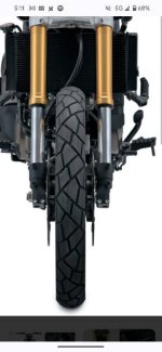

Upper triple right, lower triple right, right axle pinch, axle, left axle pinch, lower left triple, upper left triple.
