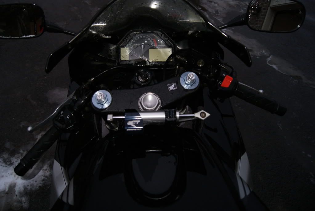

Just bought a new cbr with a steering damper on it. I have never had a dampner before so wondering if it should have any play. It can swivel back and forth a bit at both the screws even though they are tight. Is this normal?
Also just wondering if you can switch oils in the damper? Right now I find it quite hard to turn stop to stop while pushing the bike around the garage. I haven't ridden the bike yet but that seams pretty thick.

In the picture you can see the one screw at the end of the ram. Underneath the ram there is a second screw which mounts to the tripple tree. Just wanted to make sure play was normal in there.
Not normal. Every slightest moment of the steering should cause the damper rod to slide in or out of the damper body. Movement in the mounting bolts will not allow this, so the play needs to be removed.

Its mounted on heim joints... its MEANT to move!!
OK well I went out and had a look at it again. As far as adjustability goes, just figured that out so no longer an issue. As for the play it only has play up and down. I can rock it back and forth towards windshield and tank but has no play left and right. Also if i turn bars left and right there is no play in that direction. I think it might be normal

Thanks mmmnaked. Looks like I have nothing to worry about. Just going over my new bike with a fine tooth cone. Cant ride it, might as well go over it.
Ok now I understand what you mean. Up and down play is natural with those type of connections but there should not be any side-to-side play.

The words "not normal" are incorrect. While the statement that follows is correct, what isn't correct is that it's quite normal for these to be able to pivot freely up and down within the limits of travel of the ball joints at each end, and that's what the original poster was talking about. The last phrase "so the play needs to be removed" is not correct because, in fact the situation is normal, and no action whatsoever needs to be taken.

Yes, the movement is indeed perfectly normal. It's part of the design and basic function of a damper. If it didn't have this movement, it would bind up when the chassis and suspension flex.

I think fastar1 interpreted the initial poster's problem as loose mounting bolts(holding the brackets to the frame/triple). In which case his post is correct, the mounts should not have any play. At least that's what I took away from his post.
LOL yes the mounts SHOULD have play that's why they're fastened through heim joints :lol: awesome
The only thing "hard mounted" to the motorcycle is the heim joint. The damper does NOT have heim joints, the MOUNTS do, thus allowing the damper free play.
