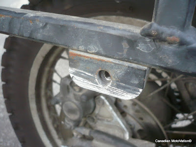

Another get off involving a blown front tube that failed at 80kph on asphalt that left the rack with the powder coat scraped off after a twenty foot slide down the road:
