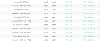

Since pretty much every Japanese manufacturer uses Yuasa as their OEM battery, I always go off that then find an equivalent:
Looks like a YTX14-BS or equivalent (assume TX14 in the Energizer chart above?) fits all ER-6 models...
@Priller Where did you find that? I'm pretty sure that's wrong, I got YTA-12BS off a Kawi parts diagram. That could also be connected to Pegassus's troubles as I think those ALL might be wrong (older ER6n models used a YTX-12BS I think)
Got it from here:
Kawasaki Replacement Battery Chart
Edit: Looks like the main difference is the 14 is 15mm taller than the 12B. Lines up with the OP complaint.
