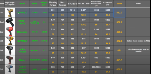

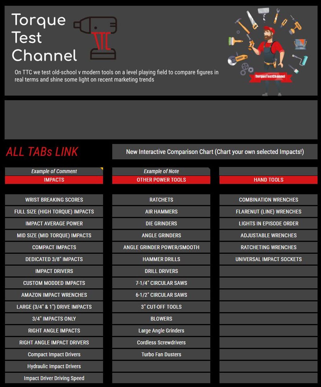

Torque Test Channel on youtube is the only place I've seen controlled, objective comparisons between various tools. They tabulate the findings and rank at the end. You can check it out to see if its worth going from ait to electric of vice-versa depending on your budget.
EDIT: They now sell access to the actual chart itself that you can search through for $21 CAD:
Keep in mind, those numbers are using 150 PSI so you'll need a compressor that can output that much to get the same results.
Some are battery powered in that chart. Also most guns are rated for 90-100 psi so while you may be able to use them a little at 150, keep a rebuild kit on hand.
