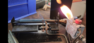

I picked up a used propane heater. It was pretty beat up, but the guy started it up and ran it for 20 minutes in the driveway while we talked and it worked good. I took the casing apart to clean up all the dust, dead bugs and cobwebs inside it, and decided to scuff up the rust and put a coat of paint on it. This might have saved my life because as I was putting it back together, I started it up with the cover off. It run for about 30 seconds then POOFF! A small ball of flame was shooting from the controller, from under the Hi-Lo knob. Apparently the seals leak. With the cover off, the gas reaches the lit flame and ignites. If I had it running in my little garage with the cover on, I don't know how much gas would leak out before it ignited. And in the several full jerry cans stored in the garage, it could have been really bad.

My propane heater after the leak ignited...

That's fun. I've had a similar crap situation where a propane torch decided to light between the torch head and bottle.
Fwiw, I highly dislike burning fuel inside a sealed garage. It produces tons of water (about 5 gallons of water released for every 20 lb tank burned). Also potentially CO or oxygen deprivation issues if you get really unlucky.
