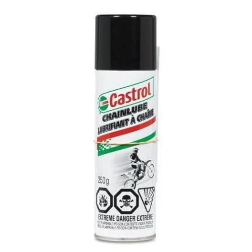

I use whatever chain lube I have on hand, at times I even used some cheap new motor oil. give chain a wipe, Wipe/spray lube on a warn chain, wipe off excess, never had an issue with flinging with any product and never had a chain or sprocket wear out prematurely. I think people overcomplicate what should be very simple maintenance...
That **** flings everywhere. Fine for a dirtbike. Messy for a streetbike
On a dirt bike with a regular chain, they actually help prevent wear.
On a street bike with a sealed Oring chain they do absolutely NOTHING to prevent chain wear. The lube in an Oring chain is sealed into the rollers when it's manufactured. The Orings keep the lube in AND keep anything outside from getting IN... like dirt... or lube spread on the outside of the chain. You can't lube a sealed chain.
Since the lube in the chain oiler is NOT getting into the chain, where do you think that oil is going? All you're doing is spreading expensive, toxic lubricant into the environment.

That canadian tire flingy crap? Stopped using that years ago.

I don't know what's going on, I use the CT flingy crap and never got a mess or crap that flings?
