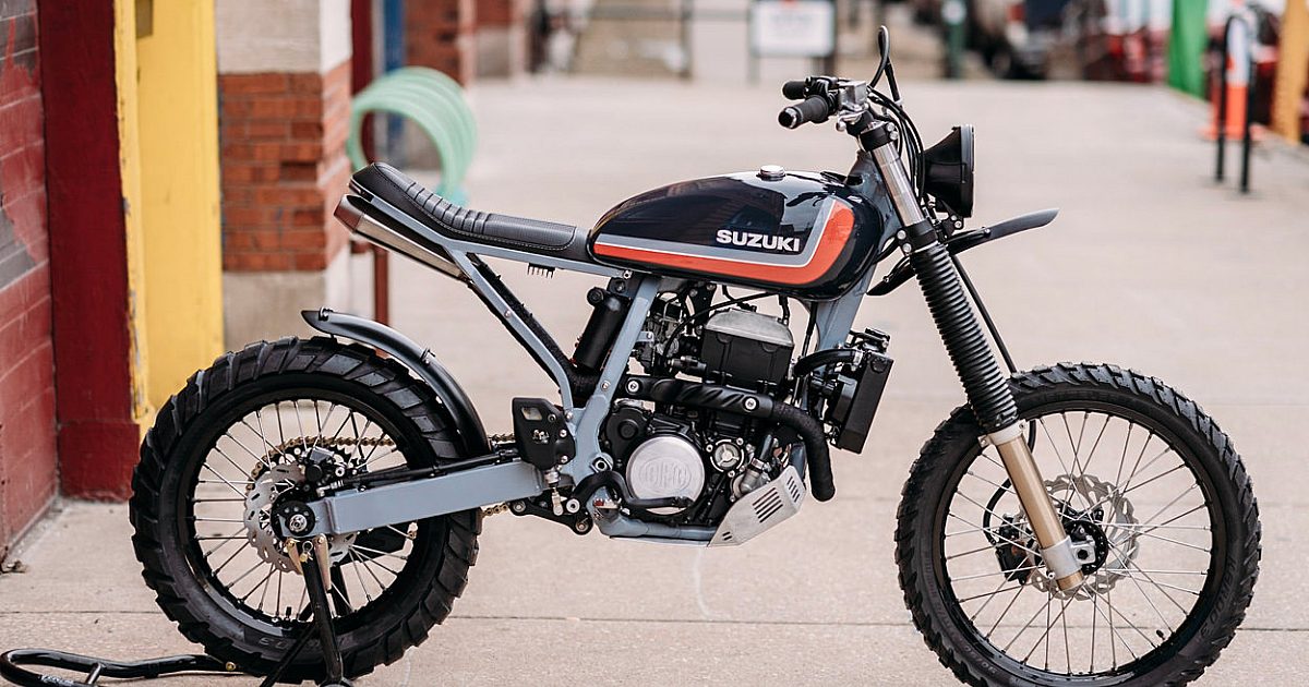

I'm also thinking about getting one as well. It's the perfect tinkerers bike imo. So many mods of all skill levels. I'm particularly in love with Federal Moto's Big Suzie build
FED-014 BIG SUZIE — Federal Moto
www.federalmoto.com
Bike EXIF | A DR-Z400 built for the streets of Chicago
Tough, agile and one-of-a-kind: is this the perfect 21st century urban custom?www.bikeexif.com
There's something for everyone on this bike.
