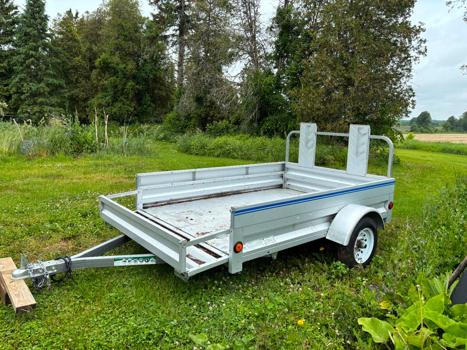

I'm looking into a new trailer. 5x7 utility.
I've noticed some have the wheel near the the mid point of the box and some noticably much closer to the rear. (see pic)
Should I be concerned too much tongue weight with something like this one shown?
I'm pulling with a Matrix that has a 200lb tongue limit.
That one has a weird forward bed extension. Set the front trailer wall where it normally is and the axle is just behind centre.
What are you looking for sides to haul crap or mostly bikes ?
The axle being close to the back of the trailer allows the weight to be more easily placed forward of the axle. This is safer to pull because if more weight is place behind the axle than in front, it will cause the trailer to fishtail. The higher the ratio of weight rear of the axle, the worse the fishtailing. the downside to this is the farther back the axle is, the more weight that's on the tongue.
The axle being back is the safest, but you have to balance that with the weight capacity of the tongue, and the amount of weight you'll topically be pulling.
I like the axle to be 60% from the front and 40% from the back, for best balance.
I'll also suggest an 8 foot trailer. It's always nice to have the option of laying a 4x8 sheet flat. You could alway leave the tailgate open (or off) on a 5x7 trailer, but then you're placing more of the weight rear of the axle.
I currently have a 4x8 trailer that holds a 4x8 sheet with about 1/8" to spare on all sides, which is really nice, but the axle is to light for the occasional gravel or triple-mix load (which flattens my springs and leave the trailer bed sitting directly on the axles).
I've been collecting materials to built a 5x9 trailer with a strong axle and leaf spring. Thing is, I don't want two trailers kicking around, and I really like that I can easily walk my 4x8 around by hand in the yard. If my 5x9 ends up too heavy do do the same, l'll like end up selling it as soon as it's built. :ROFLMAO:

As the owner and user of a 5x7 trailer exclusively for towing my GSXR 600, I can tell you the axle on the trailer is too far back for your needs.
The Center of the mass of you bike (the engine) should be close to being over the trailer axel to balance the weight. That can be fine tuned by where you bolt your wheel chock.
My trailer gives a tongue weight of about 50 lbs which suits by vehicle.
The other thing to consider is- and this is very important - is that the trailer will sway left to right and shake you car if the balance is too far forward or back. Check out you tube videos that demonstrate this phenomenon
Of course the larger the tires the better off you are too. But I think you already understand that.

"The Toyota Matrix has a maximum towing capacity of 1,500 pounds (680 kg) when equipped with the 2.4-liter engine."
"The maximum tongue weight for a Toyota Matrix, when equipped with a Class I or II trailer hitch, is 250 lbs. The maximum gross trailer weight is typically 2,500 lbs."
You want 10-15% of the total trailer weight on the tongue. Assuming a 450 lb bike and 450 lb trailer, you want somewhere between 90-135 lbs on the hitch. Less risks sway, especially in windy conditions that may unload the hitch even more.

Trailer sway is almost always caused by insufficient tongue load, not excessive tongue load. The limit to tongue load is usually the hitch limit and/or the GVWR including passengers, cargo and hitch loading combined.
