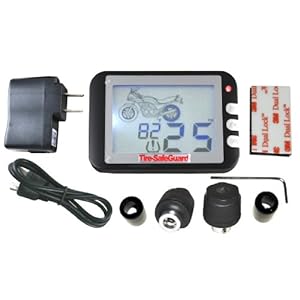

So hard to get to the Burgman 650 tire valves to get an accurate read I broke down and bought the above which works the charm.

Anyone else using a real time gauge have some insight.

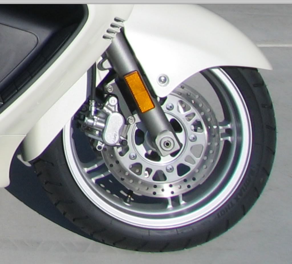

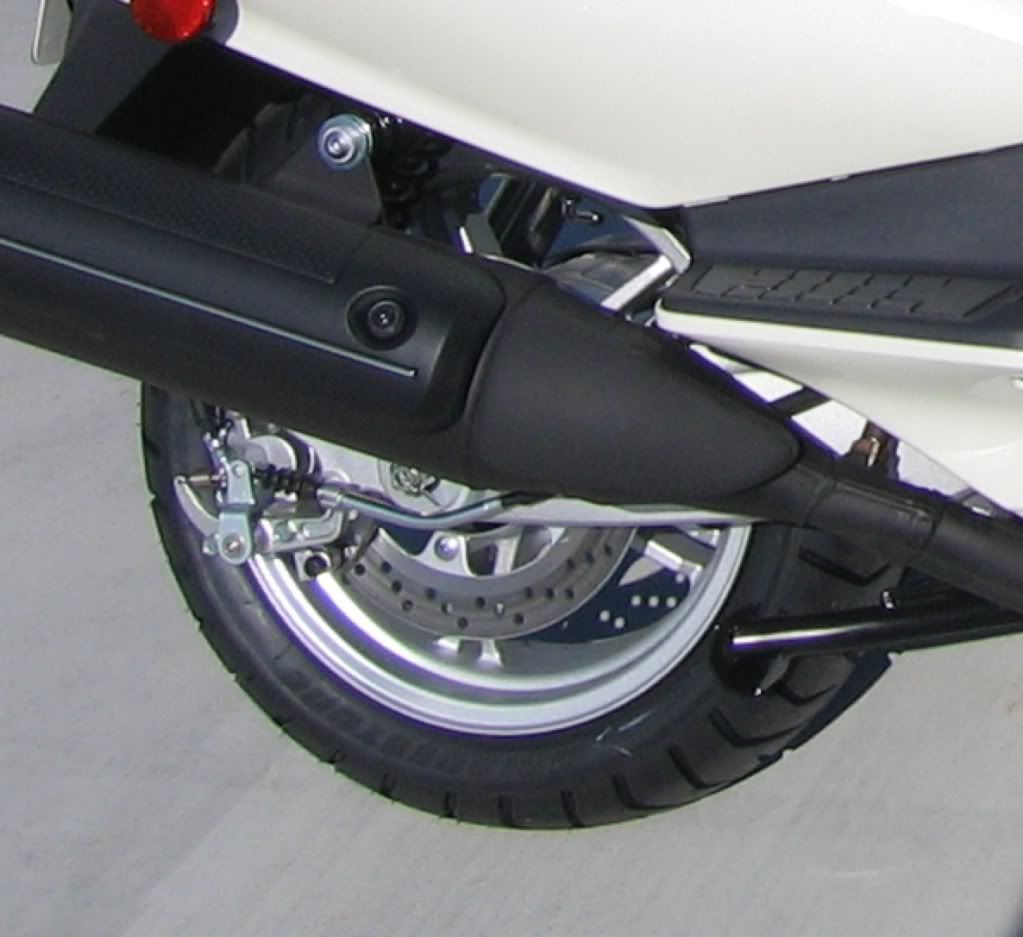

Tires are the same just a tad smaller 15s - I need a compromise range as getting at the valves is so nasty it's not something you can do reliably on the road.
Clearance to the valve is very small due to dual discs and smaller diameter. You can see the issue. Also how many actually change their tire pressure depending on conditions ( aside from off road where it's almost mandatory ).
Very different access than the 21" on the KLR ;)
versus Burgman's 15" and 14"

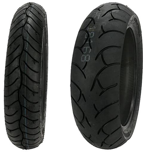

Not sure what you mean by "normal sports tires" - these are Metzler FeelFree for high speed touring/handling so I would think they are "sports tires" - the Burgman weighs in around 600 lb.
* Optimized wet performance, thanks to a high contact area and a dedicated contour to provide high-speed stability, outstanding cornering behaviour and excellent handling
* Excellent riding comfort, long mileage, even wear, thanks to the compound and tread pattern design based on the same prizing motorcycle sport-touring tyres concepts

"So hard to get to the Burgman 650 tire valves to get an accurate read I broke down and bought the above which works the charm."
^That's where I got the idea you were spending money. Did you mean it was much less expensive and better way to deal with the suspension?
No - it's a good investment to know the state of the my tires as getting an accurate consistent reading with that valve stem positioning is a total pain and now I can check every ride and during the ride - In my view that's a good thing.
The suspension is not an issue - I do have a later model 650 but I was content with it on the 2005. I was never content with the tire pressure difficulty. Now I'm fine and want to fine tune between acceptable sticky in twists and decent mileage and wear.
The real time gauge will let me do that reliably.
