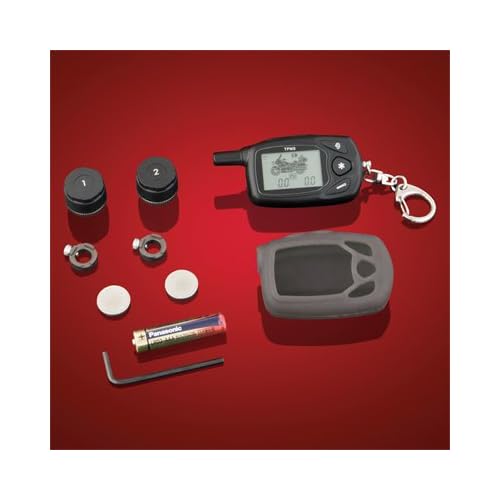

The Burgman is an absolute pain to get at with the smaller wheels to check airpressure. Some riders have used the warning caps and others this real time reporting system.
* Wireless technology allows the Sensor and Monitor to connect automatically.
* Real-time highly accurate sensor and monitor with powerful Graphical User Interface.
* Fully adjustable pressure and temperature warning range
* Both Sensor and Monitor are battery powered with a low battery indicator
* These new enhanced TPMS now include a soft silicon monitor skin for added protection.

i've got a digital TPMS mounted (on the rims). it's been 6 years now and still going strong.
very accurate and love the instant monitoring as i'm riding.
it was pricey but great peace of mind.
the system actually identified a tire leak (nail in tire) WHILE i was riding.

Yeah - think you are correct - gonna grab that motorcycle dedicated system.
