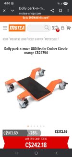

Park and move Dolly, holds 800lbs if u have a center stand. I use the lighter version for my bikes...works great
