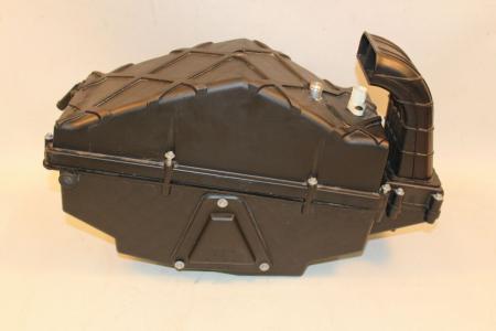

I went from this OEM airbox;
0
to this Motohooligan airbox;
A MASSIVE difference in response and sound, but then I also added an exhaust and re-mapped it... and removed the 2nd butterflies, stepper motors, 2nd air system... yada yada yada.
