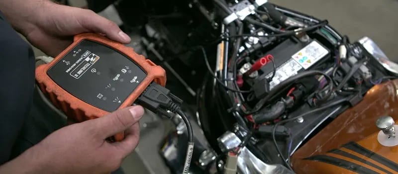

You can use the trip reset button to cycle through codes in each of the code categories and note the DTC itself. Here are the possible codes and their meanings ( not all codes apply to every model, a service manual for your year and model is helpful).
How to access codes from the dash
  1. Set run/stop switch to RUN
  2. Hold down the trip reset button while turning the key to the ON position
  3. Press and release the TRIP button to cycle through different modules.
  4. When you arrive at the module you want to investigate, hold the TRIP button and it should cycle the module specific parts and codes (I think HD calls them PART NUMBERS). Note that a code doesn't equal a fault -- you need the manual or a good interweb resource to understand codes
The onboard diagnostic system can also display a number that corresponds to the trouble code, and it will allow you to clear the code. This part is tricky without a manual. Try this link for more:
