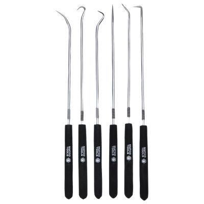

To remove the pins as they are called you normally use a pic set to bend the tab down then pull the wire out. As for the wiring I would follow the above diagram. The pick set looks something like this:
