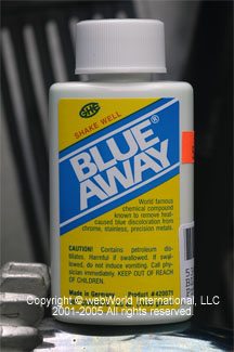

Yep, common question on ADVRider and other GS forums, the headers on the boxer engine turn blue almost immediately when you ride it off the dealer lot.
There's a product called Blue Away that works well for that:
Most prepackaged SS potions are simply 10% citric acid. This acid passivates stainless by dissolving the free iron that causes dullness and bluing. The cleaned up stainless reoxidizes its own protective surface.
these products won't remove scratches, that takes fine polishing with progressive abrasives.
I didn't get that @Chris-CJ was asking about scratches. Just bluing:
Correct, so all he needs is a nice chemical bath!
10 minutes in a 10% citric acid tub should do. If he doesn't want to remove the header, a loose wrap using acid soaked rags will do.
