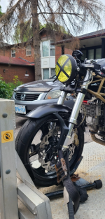

Was just looking at a Burgman and thought about going to see it with my trailer and a lowball offer. After looking at pics of it I would need to buy the straps that attach to the hand grips. Never had need to do that before. Always been able to find a spot inboard of the switch gear on the bars or triples.
If they're anything like other Suzukis, the rear passenger grab handles should be sturdy cast aluminum. A second set of straps on the folding passenger pegs wouldn't hurt.
Found this on the interwebs:
009-jpg.2552
Looks like soft straps around the bottom of the triple tree around the forks, as well as the passenger grab rails to compress the rear.
Only complication is the soft straps in the front are pulled forward and not out to the sides, presumably to clear the tupperware around the front of the bike. You may need a good chock to prevent the front of the bike from moving laterally too much, in that case.
Or use Canyon Dancers. They're only $30, but you can probably fabricate something similar for cheaper, as that seems to be your jam.
009-jpg.2552
Where the hell is that front strap going to? lol
Just run your strap around the fork tube and over the axle as you would with any other bike. Then you're strapping it down without putting any unnecessary compression on the suspension. Around the rear I'd go around the base of the rear shock on the left side, and probably through the wheel on the right. Easy peasy.
Four straps, ideally kept at 45 degrees forward, and 45 degrees outward, two pulling forward, two pulling back.
I think what he did was wrap a strap around the front tire, then took the strap that was wrapped around the fork and pulled it forward to that strap instead of out so it wouldn't put pressure against the plastic when tightened. Kind of a workaround bodge job and provides nowhere near the lateral stability if the straps were higher on the bike. Handlebars would be the #1 best place to pull down from.
45 degrees out from the fork isn't possible when there's tupperware in the way. Need to get a bit more creative when there are fairings vs naked bikes.
