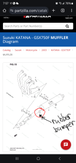

There should be a rubber nob on my exhaust that prevents the center stand from rattling against it. It's gone missing.
I don't now what is called so I used the best resource I know of to identify it, Partzilla. Unfortunately, as you can see on the attached screenshot, they failed to list it.
Does anyone know what is called, the part number, or where I can get a replacement? TIA

It's only there to stop the rattling so you could fake that part in numerous ways. Any hank of rubber ziptied in place should stop the rattle. Or maybe a slit piece of rad or fuel line wrapped around the c stand where they come together would work as well.

sure it's not welded on or something? I'd say its part of Assembly 6 in this picture.

It will be a rubber slug with a tapered rubber nub that gets pushed thru / into a hole in the muffler bracket. Pretty sure my method(s) will work.
No, it's definitely a rubber nob. There's a hole that it plugs into. I took it off last spring when I was swapping exhaust, but I must not have had it in tight.

Part ordered! Thanks for the help.
