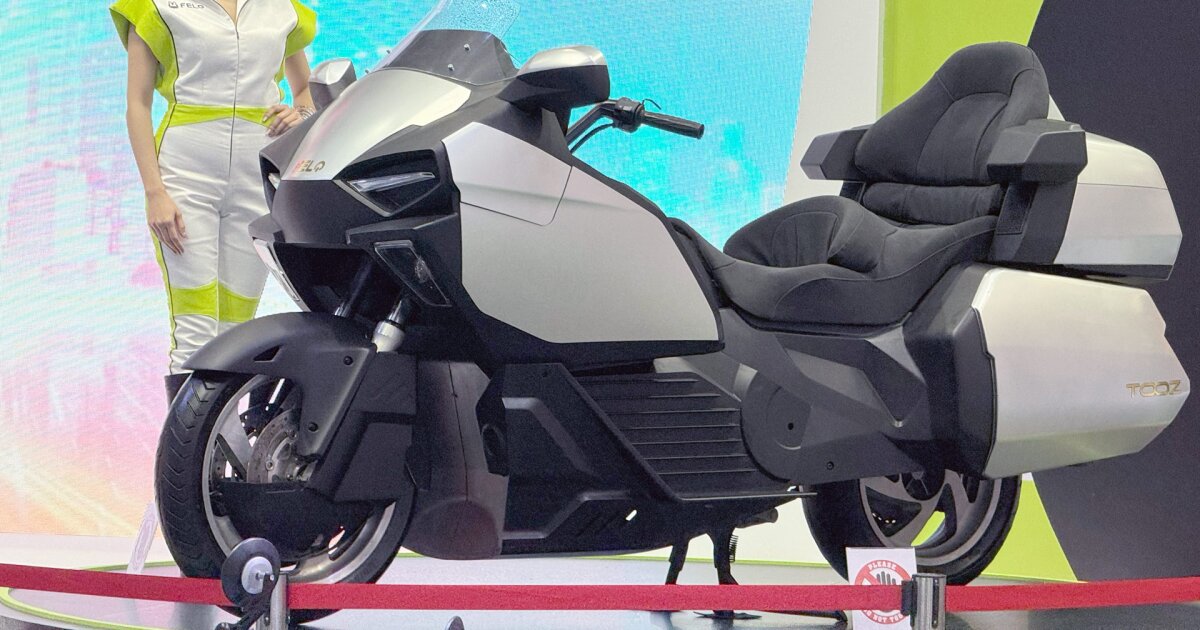

For a one person transporter motorcycles tend to have the aerodynamics of a slightly rounded brick. This one looks similar to the Goldwing so Voltwing? I'd like to see the specifications, especially weight. A ready to travel Goldwing is about 1000 pounds.
IIRC a Goldwing motor/ transmission combo is around 300 pounds wet. What would be the weight of electric motors, drive and battery?
I don't know if there is a typical weight per KW of power with lithium ion batteries. For simplicity I think of a 60 to 80 KW EV car battery being about the size of mattress and weighing 1000 pounds. Is 15 pounds (7Kg) per KW in the ballpark?
Battery cost and fragility would be a game changer for me. Stories are around that the EV car dealers write off batteries that have dents in the cases for fear of fire. Motorcycles have less protection.
I can see decent mileage around the city as windage is minimal but heavy touring bikes aren't fun in the city.

I say BS. The math doesn't work. A goldwing uses about 50% more fuel than a CB500F. A zero SR/F is a similar size (and most importantly frontal area) to CB500F and has a 14 KWh battery and a rated range of something like 100 miles. Add in the larger size and larger range and the TOOZ is battery is something like 95 kwh(14/100*450*1.5). Hahaha. That is is the size of the pack on a tesla. This is expected as bike frontal area isn't that much smaller than a car and drag coefficient is abysmal [something like 0.7 compared to <0.3 for most electric cages] so total drag which governs range is pretty much identical. That's a 625 kg battery. Sounds like fun :/. Now, to be honest, the bike may happen but that range is vaporware. I expect half at most and the bike will still be heavier than PP's.
EDIT:
I guess an upside is Tesla apparently has 100 kwh down to 0.4 m^3. That could plausibly fit in a big bike (if you don't care about the weight).
