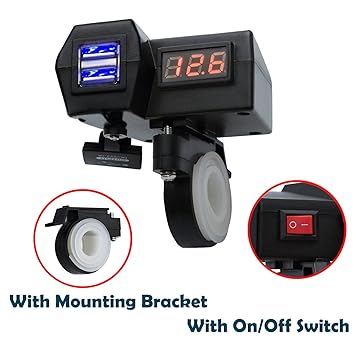

It's odd I was just thinking to get one of the handlebar USB outlets with the voltmeter.

A handlebar mounted voltmeter would have given me warning....on the buy list this weekend.
