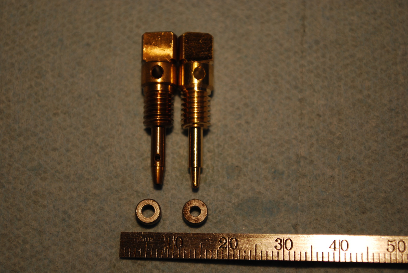

The only difference is a bleed bypass hole in the valve, this makes them have little to no difference between all the way stiff and all the way off. I have those valves swapped out for $100 with new fluid and bleeding and it then becomes the exact same as the aftermarket Ohlins. So for +$100 on a bike that comes with a OEM Ohlins its still a great deal considering you then have a $700 value damper for $120ish with shipping...
OEM Ohlins valve with bypass hole on bottom on the Left, Aftermarket Ohlins valve with no bypass on the RIGHT. Have this swapped out and your OEM market Ohlins becomes the same as the $700 Ohlins damper kits
Ohlins rod type only. Love it.
OEM Ohlins valve with bypass hole on bottom on the Left, Aftermarket Ohlins valve with no bypass on the RIGHT. Have this swapped out and your OEM becomes the same as the $700 kits
